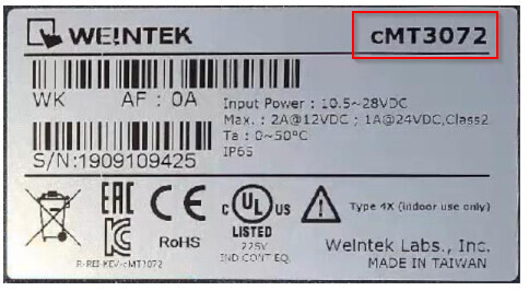

The HMI model can be found on the back of the HMI within a grey or silver label:

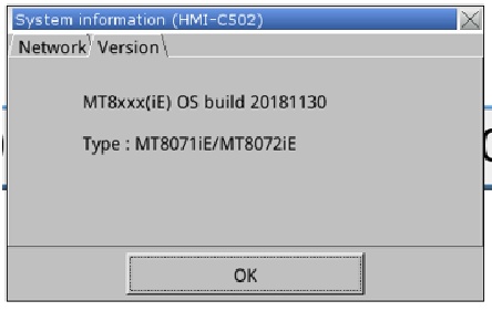

On a non-cMT series HMI:
  1. In the bottom right corner of the HMI display select the “Arrow” icon:
  2. Within the following menu select the “I” icon:
  3. Within the system information menu select the “Version” tab:

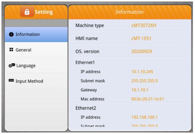

On a cMT series HMI:
  1. Select the orange settings button located in the top left corner of the HMI:
  2. Select the “Information” tab:
