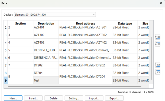

Hello fellas, i have an issue when i switched my data import from a siemens PLC to symbolic addressing, if i try to use contiguous addresses with the data sampling i have an error message saying that the section has an invalid read address, this problem dont happen if i use absolute adressing or if i separate the Tags in individual Sections, but the LOG is a mess because of that, any idea?

Hi Daniel, in the following images i try to get information from a DB block in my PLC with more than 50 consetutive Real Values after the test one, so it should be accessing those without issues.

Thanks for providing the screenshots. So with Siemens symbolic addressing, contiguous reads are only possible when the variables are part of an array.
Right, i thought it could continue, similar that the absolute addressing. Got it haha
