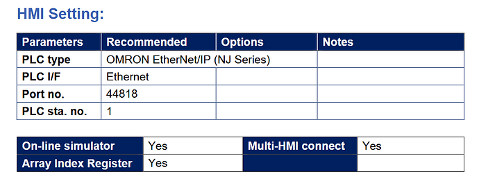

  1. Here is a LINK to all of our PLC connection guides. Could you ensure that all of the HMI setting parameters are correct through out the project.

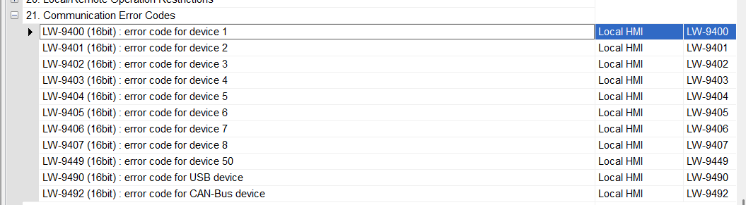

  4. Below are communication error codes linked to system address. Could you plot these addresses down and see if you get a error code out.
