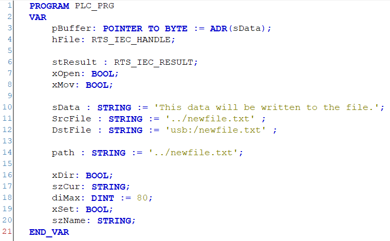

I attempted to access the USB port on a cMT-2078x V2 through codesys SysFile functions. It does not appear that is possible. I’m pivoting to having Easy Builder Pro access the USB port and pull the information I need to internal storage, then access the internal storage through my codesys code. Any help here would be appreciated, for either accessing the USB port directly through codesys or pointing to internal storage in the HMI.
Hi @jbarber ,
Thank you for your question. Here is a sample project that creates a file in CODESYS internal memory and then copies the internal file into the USB. Please let us know if this approach works for your project.
