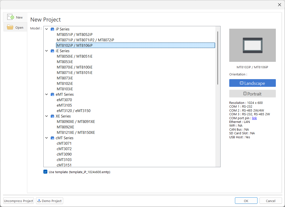

What version of EB Pro are you using to access this HMI? Using the latest version of EB pro I was able to open up a project in this HMI model.

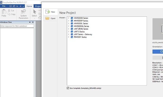

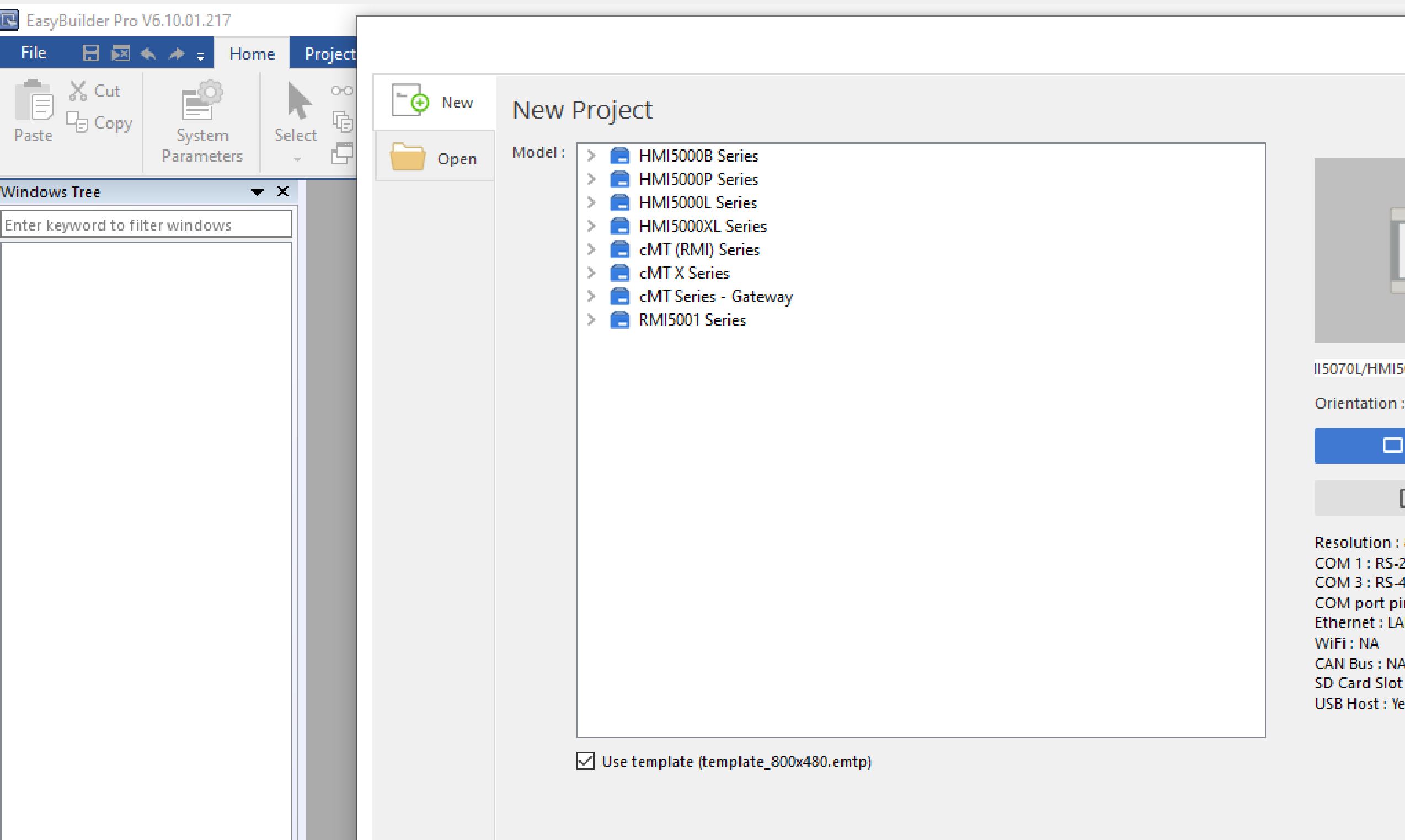

It’s version 6.10.01.217. There’s dropdowns for cMT series and HMIxxxx series, but don’t notice anything in the MT8000 range

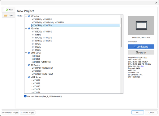

Hi @edanish70,
This model should be a bit further up the list, here is an example:
Do you see the MT8102iP / MT8106iP option?
Don’t have the option for those units

The model or series name “HMI” such as “HMI5000” is a prefix used within Maple Systems software not the software found on our website. To access this Weintek model, please download and install the software listed on the EasyBuilder Pro page of our forum: https://forum.weintekusa.com/t/easybuilder-pro/
That makes sense now. Thank you!
