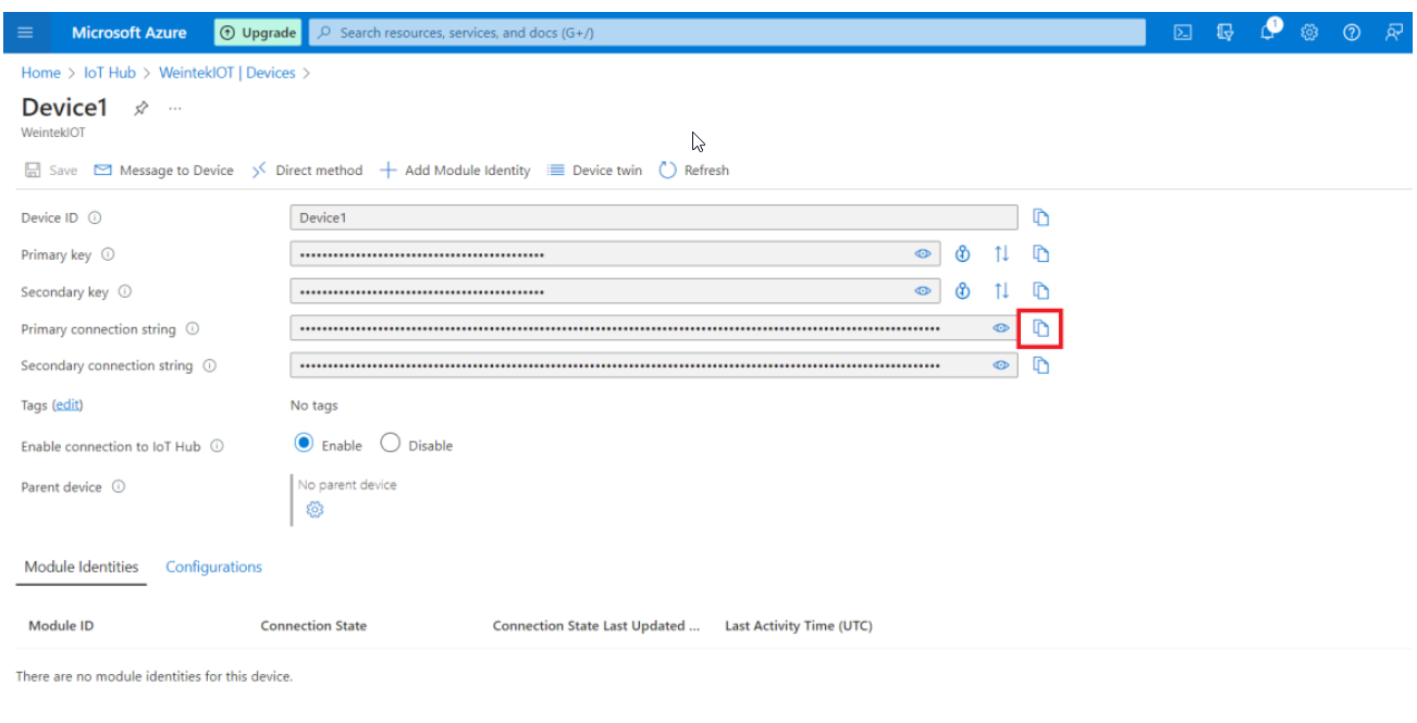

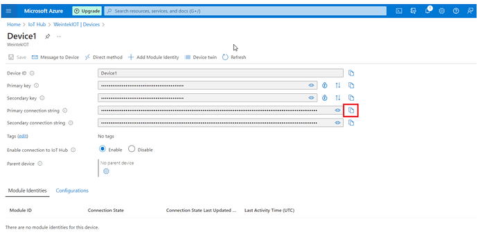

The connection string should come from the “Primary connection” string in the Azure IoT dashboard:

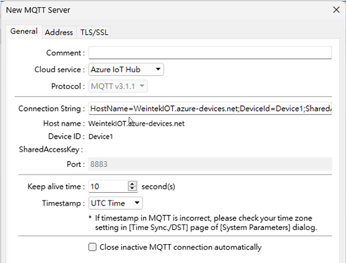

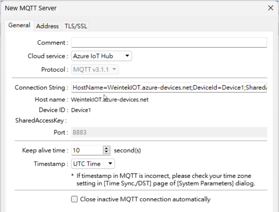

It should have a format similar to what is shown below:
Hi Brendon, thank you so much for your help. The page I’m using doesn’t look exactly like this one, but it helped me understand how to fill out those fields. I’ll keep trying to see if I can get the connection working.
