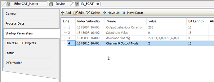

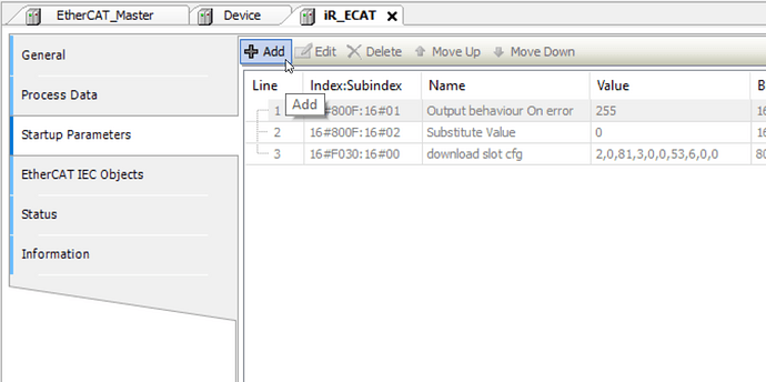

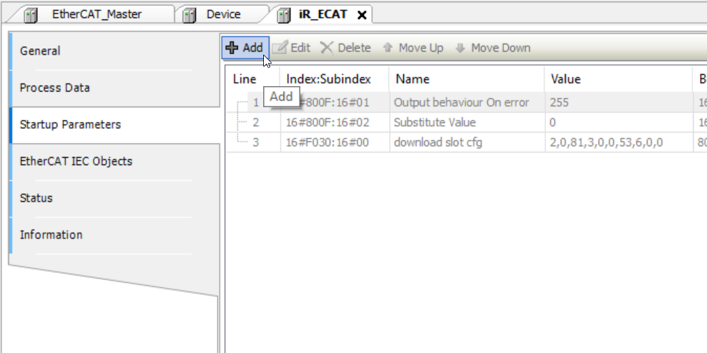

To configure EtherCAT parameters, please visit the “Startup Parameters” tab of the EtherCAT device as in the example below:
  1. Click the “Add” button to add additional parameters:

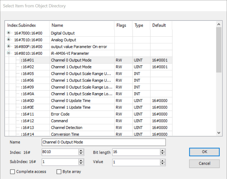

  1. To add a parameter, expand an index and select the desired parameter from the sub-index list:
  1. Configure the “Value” and click “Ok” to add this parameter:
    Note: In this example 0: Close, 1: ±10V, 2: ±5V, 3: 1-5V, 4: ±20mA, and 5: 4-20mA. Thus, channel 0 is configured to output 2: ±5V.*
