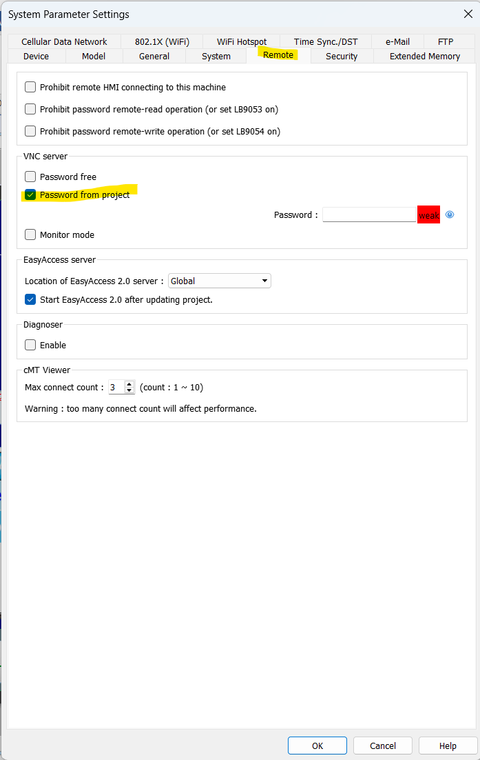

  • HMI Model: MT8102iE
  • EasyBuilder Pro Version: V6.10.01.259
“VNC Login Password” is resetting to default value after device restart. Won’t stick.
(Image of settings panel) https://i.imgur.com/OPFDKxh.png
Runtime changes to VNC password don’t persist?
Hi there,

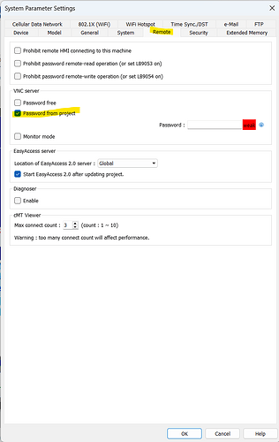

Within system parameters, under the remote tab you’ll see a section for “VNC Server”. Do you have the “Password from project” feature checked?
