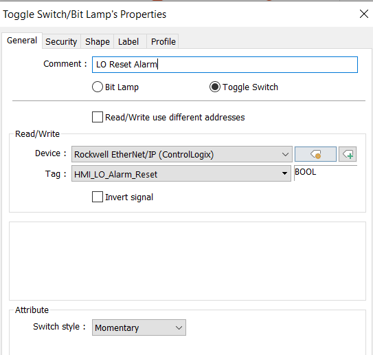

Aaron,
Each of the buttons that are creating a duplicate entry in the Op Log have the same setup. They are Toggle Switches, however are utilizing a Momentary style:
We are guessing because they are momentary switches that we’re getting one Log entry from the “push” and one from the “release”. The Op Log settings are enabled utilizing the “Enable” check box and providing custom comment based on our input. Seems pretty straight forward. We are not getting a double entry from the Toggle Switch style.
Pat
Hi @psimm,
Your guess is correct. When a toggle switch is set to Momentary, the Operation Log records both the ON action (when the button is pressed) and the OFF action (when it is released). If the button is pressed and released quickly, this can appear as a duplicate entry. If the toggle switch is held for a few seconds, you will see that the second log entry does not occur until the button is released.
