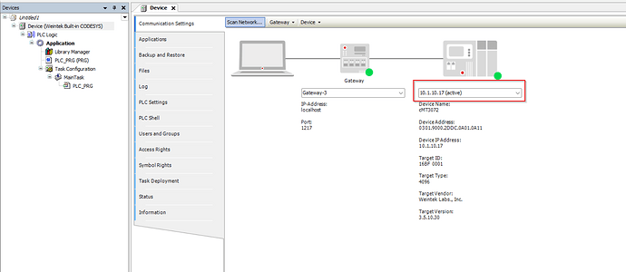

Can you try the following:
Please enter the virtual IP address directly into the drop-down menu to establish the connection.
Could you also enable Codesys login as in this post: How to enable Codesys login
Also one more question. Is the virtual IP at 10.16.32.20 routed through LAN1 or LAN2?
