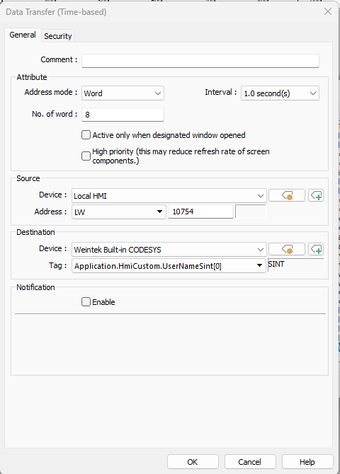

This is possible, but a key point to remember is that with our client application cMT Viewer technically multiple users can login at the same time. However, the username if the user that is logged into the local HMI is stored within LW-10754 ~ 10761 (8 words). To transfer that into CODESYS you can use one of the methods shown within this post: Link

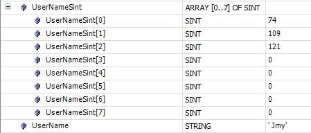

I almost got it to work, but it seems as if the data transfer is skipping every other letter in the user name. I’m logged in as “Jimmy” and the data transfer is giving me “Jmy”.
Also tried logging in as Operator and got “Oeao” as the string conversion.

Here’s my Data Transfer
Here’s the resulting data in Codesys.

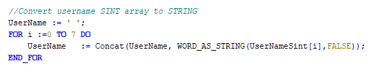

Here’s how I’m doing the conversion in the PLC code. This should work fine, but I’d expect the first 5 elements of that SINT array to be populated instead of just 3 when logged in as Jimmy.
I figured it out. At some point when experimenting with this before asking the forum question, it seemed as if EBP was wanting me to do the data transfer to a SINT array. I don’t remember what made me think that.
Just changed it to a WORD array in Codesys and it works fine if done like below. Thanks!
