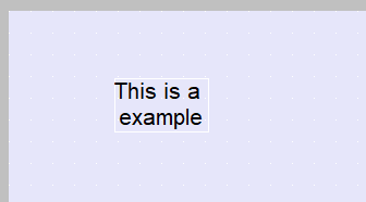

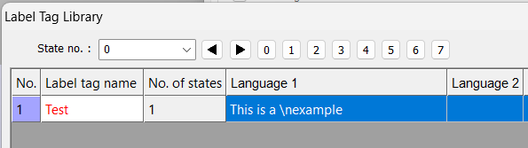

What do I do if I want to use the label tag library like this, for different languages, but need the label to word wrap onto multiple lines? Is this possible? It seems like the text is only coming out in one line right now.
Hi @jrnewghahato,
You may insert a line feed character, \n, into a label to adjust the line count:
Here is an example:
