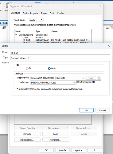

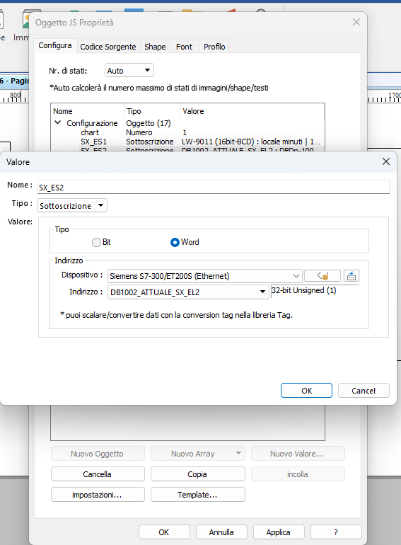

Hi,
I’m connected to an S7-300 PLC, and I linked them as you can see in the image.
As a type, I tried both “subscription” and “Tags”
I also tried linking the minutes system variable, but that didn’t work either.
I also inserted numeric fields with the variables into the page to see if they were imported correctly, and from there I can see the PLC numbers.

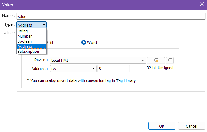

Hi @jackluz ,
I have a couple of solutions for you to try.
First, within the config tab, change all the values from “subscriptions” to “address”. This is because the getData function you have set up is primarily for addresses.
Another possible solution I want you to try is saving const addr = this.config[varName]; to a variable outside the getData function instead of declaring it inside. This sometimes solves the issue.
Lastly, here is a working demo project I created using your code. I did add a setInterval function to grab the data every second for testing. You can view the results in the EB Pro Diagnoser, under the JS tab during a simulation: Demo Project
