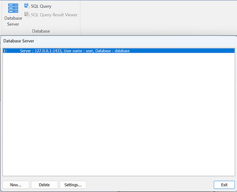

Hi everyone, can someone guide me how do I send the data from my plc to my SSMS database? I’ve already have all connected but I only can send the data through my ‘Online Simulation’ in easybuilder.
Thanks!
Hi @Rafaelk21,
Is the database hosted locally (on the same computer you are using for development) or cloud based?
Yes, same computer that I’m working with
Hi @Rafaelk21,
Thanks for the quick reply. Just for our reference, before you download the application you change the loopback IP to the PC’s actual IP, correct?
No, im using 127.0.0.1 as IP from SSMS, is that the question?
Sorry for any confusion, but yes, that was the question. Before you download the project, you should change the IP used within your project from the loopback IP of 127.0.0.1 to the PC’s actual IP, then the HMI should be able to reach the database.
Oh just to be clear, I need to use my pc IP in SSMS is that it?
and where I change? In SSMS or in database setting in easybuild?

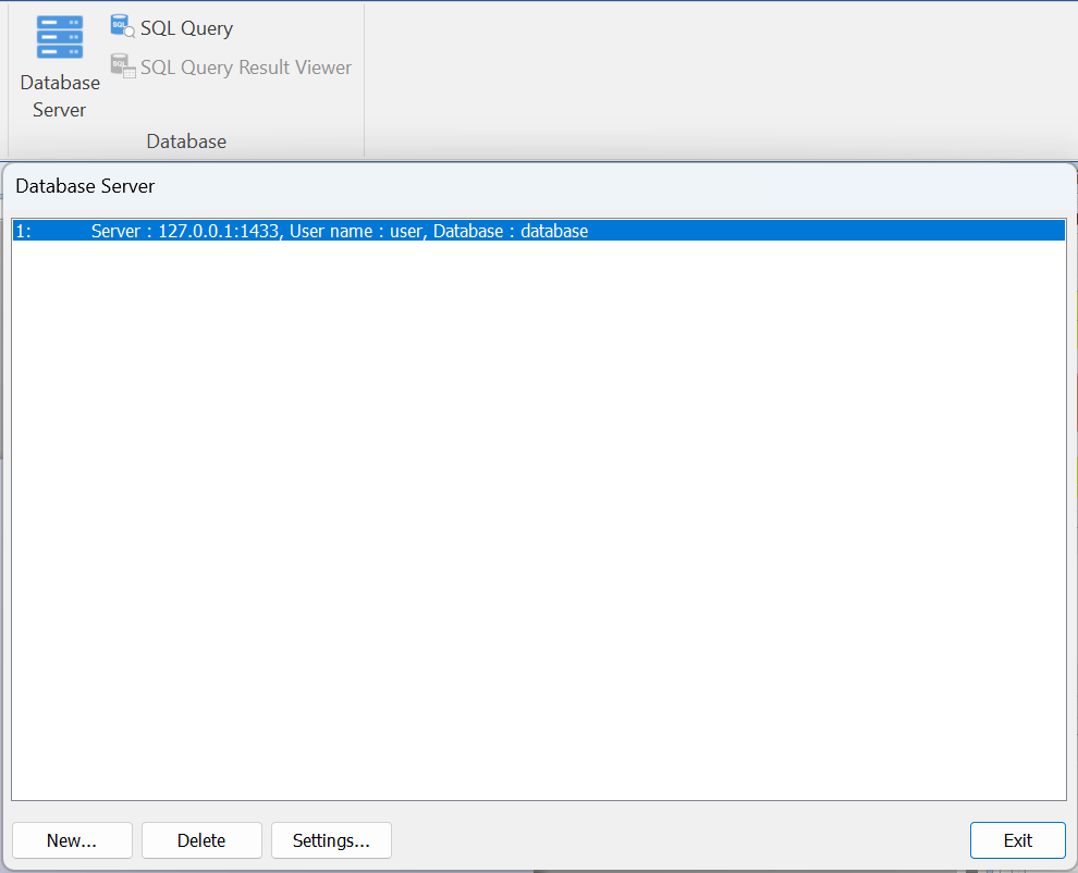

Within the “Database Server” settings of EasyBuilder Pro:
Yes, that’s correct!
Ok, one more question, the port number I leave as 1433?
Yes, that is the default port for MS SQL.
