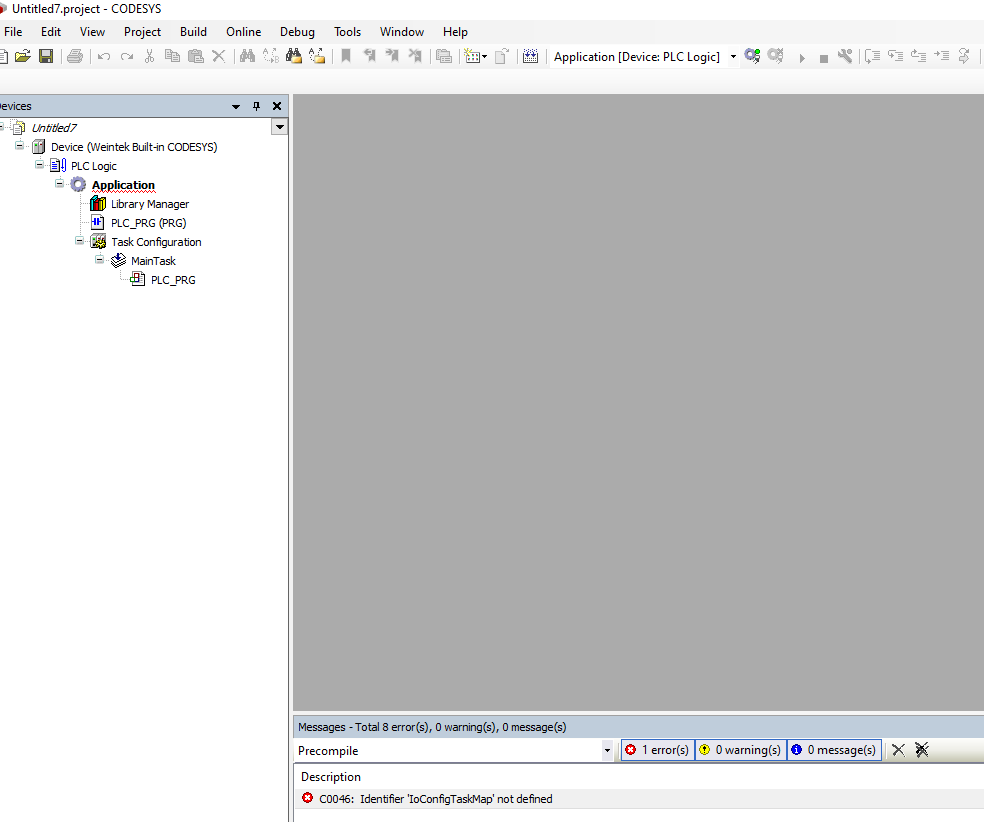

C0046: Identifier 'IoConfigTaskMap' not defined
I just started a standard project in Codesys 3.5.15.50 with RemoteIO 1.5.3.516. I get This error message. C0046 if I ignor it and keep ading devices the error count exceeds 500 and stops counting. Do I have the wrong version of RemoteIO or what?

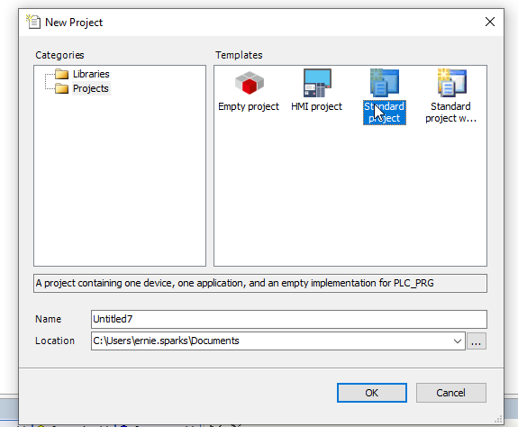

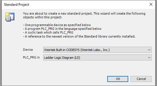

  1. created standard project.
  2. selected Weintek Built in CODESYS + Ladder
  3. after build is created you get the C046 error message.
any ideas?
